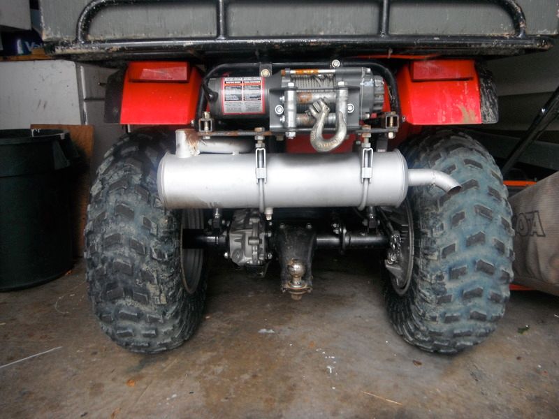

My muffler went south also,went to an onan generator muffler made for motor home . $30.00 for the muffler.
It has a side inlet but this one was near the end ,would have fit better if it was in the middle,had to make a J pipe to help with the off set so the muffler would not stick out to one side . Very quite set up . But I think it has to much back pressure ,as when i Rev it up The carb is making a deep sound coming from the air box..
I might have been better getting a diesel Muffler as they are built so you can look straight threw them. Gasoline mufflers normally have a maze for the exhaust to go threw.
Removed the whole honda muffler,added a pipe in its place and attached the muffler out the rear.
