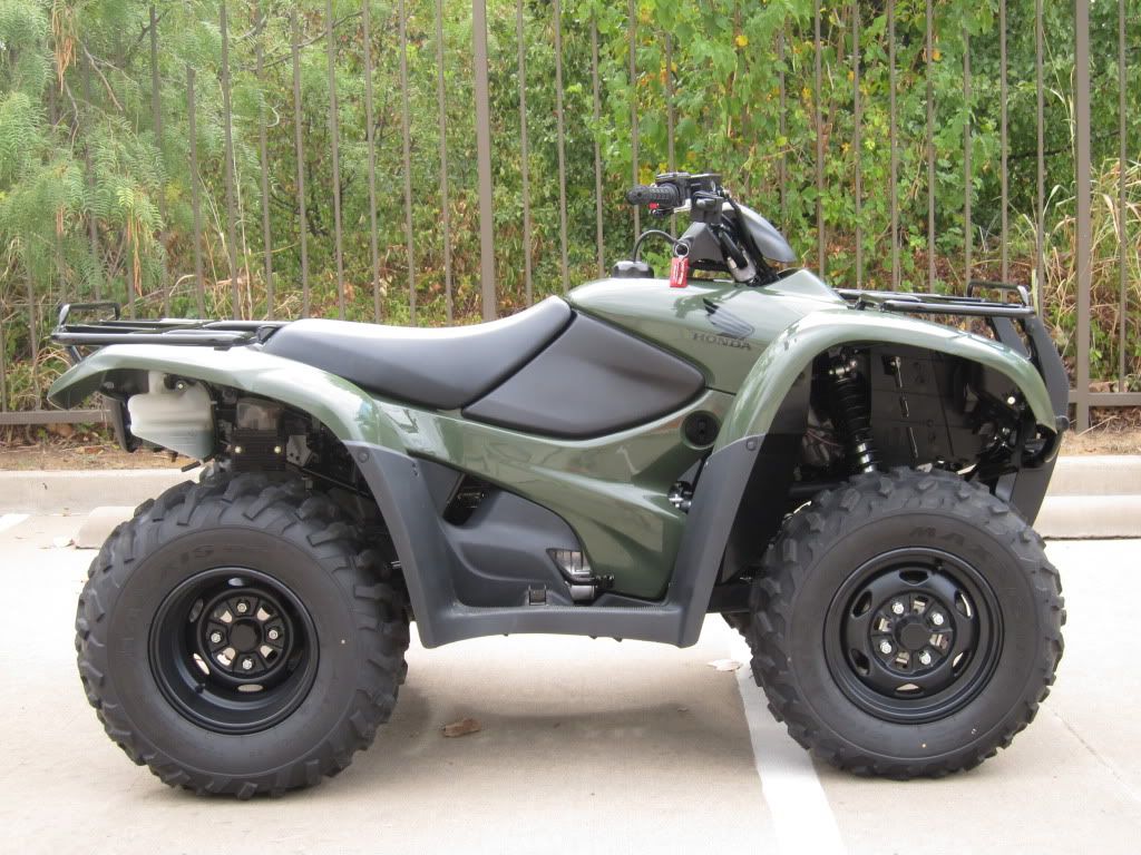

oh, and here's a picture to prove our purchase!
