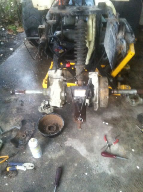

I got the new axle in today but I'm leaving for a hog hunting trip tomorrow. When I get back I'm gonna put the rear end back together and put her up for a while till I can find some more money. With the cost of the top end build and now the whole rear end I'm out of $$$$.

don't I know that fealing !!..lol.. it add's up real quick bro !..I spend more cash on my rebuilds than I should ?..but hey..thats how I roll !..I want my rides to be good as new..and look new as well !..lol.

Ya I hear ya. It's just a quad for hunting but I wanna make sure it's right.
I'm gonna do all new rear diff bearings and seals and all new axle bearings and seals as well as getting a used but good brake plate and drum from dak.

for the most part..the differental has all the seals and bearings in it, and the rear brakes backing plate has the other bearing and seals in it..thats all there is too the rear end. you can get a kit for the differential, and a kit for the backing plate..these parts will solve the rear end for bearings and seals..then yu'll have to deal with the front end. keep in mind..the front end is ALMOST the same set up as the rear differential..but not quite the same !. you still have large bearings for the sides..or ring gear ..then have oil seals for the outter case for the drive axles..thats all there is to that. then you will need bearings and seals for the spindles..thats pretty much it.
oh..and you will need a seal for the metal brake drum cover..they are cheap.
