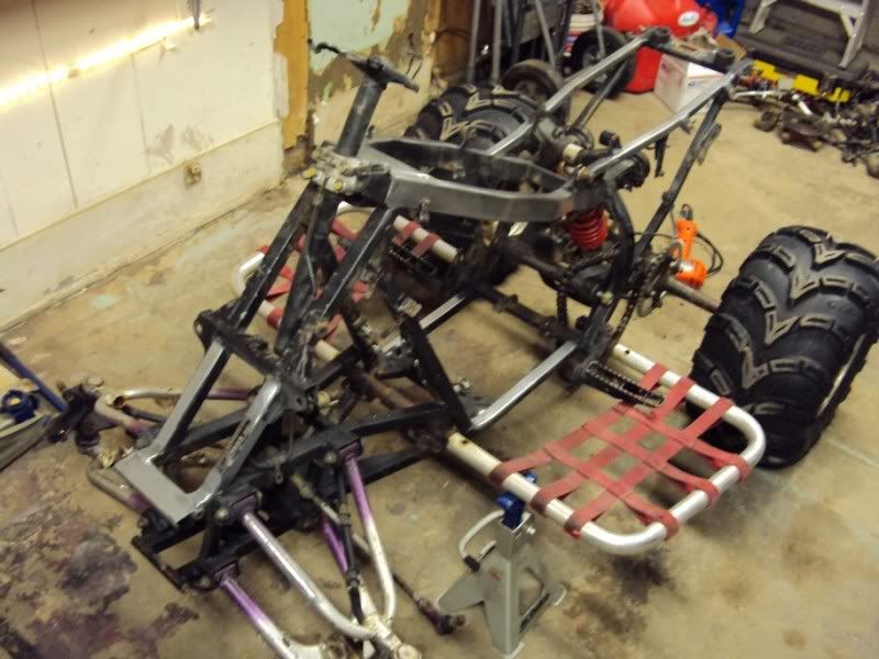

*Update*
So I have it all completely apart and I'm stripping the frame down and repainting it and the rear swing arm/ axle. Also have the motor torn apart and got a new cam chain, cam chain tensioner, cam chain guides and some new valves and am getting them and the head resurfaced/ reseated then once all that is done I'm gonna put it all together and put a new carb rebuild kit on and fixer all up and go from there.
Hopefully it starts... if not it will look good. LOL I went with a flat black and I'm gonna clear coat over that and I'm leaving my nerf bars chrome... so It will look nice. I'll post some pics up soon.

BTW here is a teaser.
The frame is just primed this is the second coat. Also the rear swing arm is primed... it's getting there!
