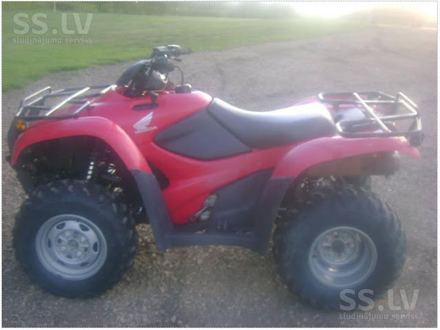

Hello. I am willing to buy TRX 420 4x4...
But I have some questions to advanced users...
1. What to check when buying it
2. It is 2007 year - and offer is for 3000 USD. Is price ok
3. It has 550 miles on it. Is it much for ATV or no?
4. There is one more offer - same price for RWD. should i go with RWD or 4x4?
5. What else should i know when buying it...
Here is a pic of advert for 4x4...3000 USD (including winch)
And here is RWD... for same price - as is.. no other things.
Please help me with advice.
And overall info would be good - are these ranchers good. do they brake a lot if taken good care of.
Yes and main question - is 550 miles much on ATV. i dont know engine hours - that' s bad i know. Maybe there is hour counter on panel? Is there a way to check?
And if there is - how much is much :D when better not to buy than buy.
Thanx in advance.

Hello, welcome to the site. I know nothing about the Latvian economy, so I can't say if you're getting a good deal or not. In the states, $3000 for a 2007 4x4 TRX420 with a winch would be a good deal...I'd certainly jump on it.
1,280 Posts
Agreed, and as far as I'm concerned, buying a utility ATV without 4x4 is like buying a car without AC. You may never think you'll ever need it, but that one time when you do you'll be kicking yourself for not having it.
550 miles isn't too much. What are the hours? If the hours are low, say under 100, then I'd certainly not worry too much about the mileage. If there are 10 hours on it and 500 miles, then I might wonder.
It really just depends how it was riden and taken care of. If it looks nice and clean up under it and isn't coated in mud up all over the air box. If the oil is clean, looks like it's not all bent up and has all the parts, then chances are good it's OK. You just have to get a gut feeling about it, and if something doesn't pass the sniff check [meaning you get a bad felling] then just walk away.
550 miles isn't bad. I can put that many miles on one in 3-4 rides easy. It will have an hour meter on the speedometer/display.
