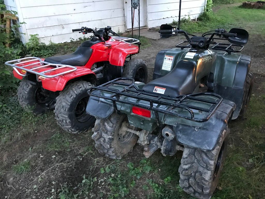

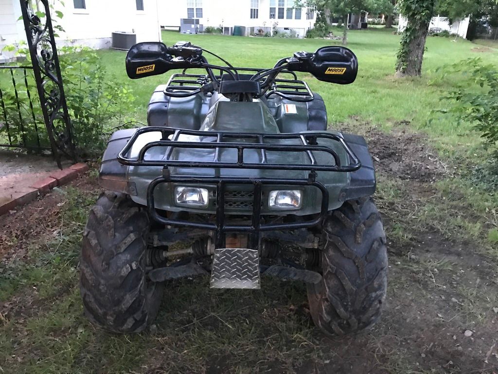

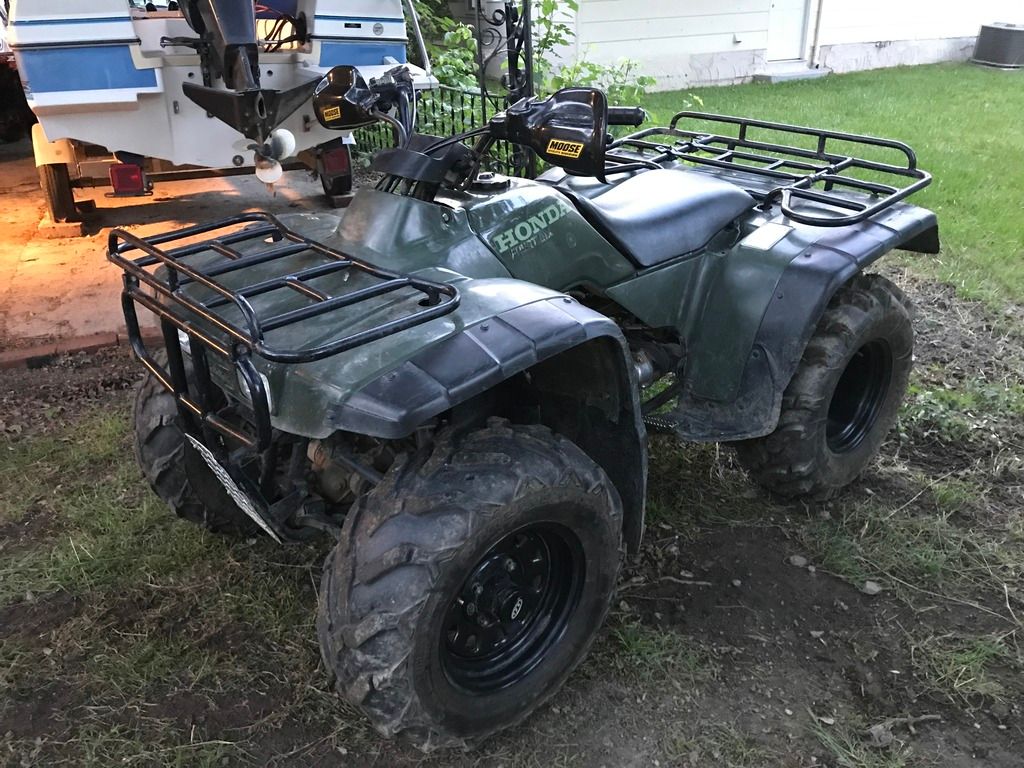

I picked up a 1998 fourtrax 4x4 electric/kick start. Really like it so far, very different experience from my 2004 recon. Came with aftermarket wheels, moose hand guards, plate skid, etc.
How much is shared between the recon and the fourtrax 300? They look similar, but i dont see much of anything that is the same. The recon is more narrow, for sure. Both mine have been upgraded to 12" wheels so can't compare stock.

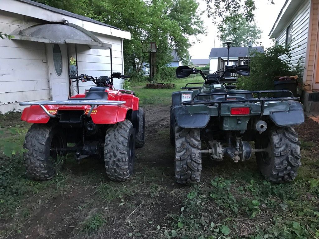

I understand. They are very different. I was curious if there were anything that crossed over - part number wise. Like the seat looks almost identical, but mounts differently.
Driving wise the fourtrax turning radius is horrible, recon turns on a dime. The extra 130lbs on the fourtrax shows in how it rides as well. The recon is much more fun, the fourtrax is so much more capable. I really like it so far, but I'd have to keep the recon to play. The fourtrax stays too in control for me. I like being on two side wheels too much to only keep the fourtrax. Lol

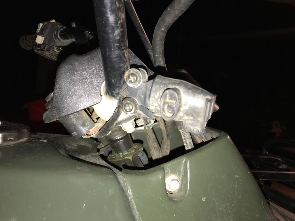

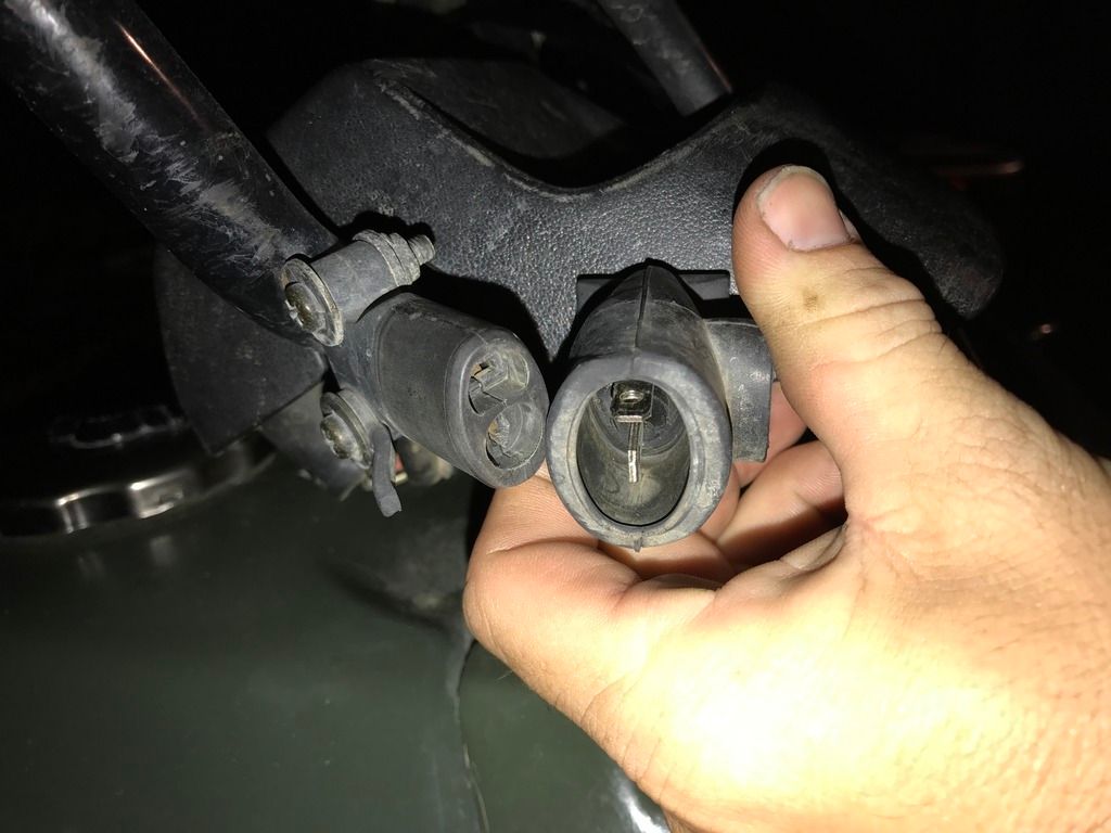

Also, any idea what this is on the side of the handlebar? Power outlet for an accessory? Particular one? Has a - and + output on bottom so I was curious if anyone has seen a light or something else with this plug.

because the trx300 is 4wd !..lol. it's not meant to ride anything like the trx250 recon. and yes, that outlet is a 12 volt accessory outlet :).

if ya reach in there where the plugs are with a pair of needle nose pliers ?, you can pull the whole plug out, and on the end of each plug, is a screw to attach a wire. these were meant for spot lights back in the day, as Honda sold this model as a ranch hand back then for the most part :).

you can also wire up a 12 volt dc air compressor to it as well.

Thanks. Any idea what amps it can handle?

I don't have my service manual handy, but if you down load it, get your hands on one ?, it should tell you ?. other than this, I do not know.

Ok i have the FSM and it wasn't shown so I wasn't sure if it may be common knowledge. I grabbed it from the manuals section today when i picked up the new 300. It's possible i overlooked it, but i didnt see it anywhere. I'm guessing 15amps is close to its limits between what the stator and the battery can handle.
5,960 Posts
The FSM specs the 300fw alternator at 0.22kW @ 5000 RPM, so 220 watts gross. Doing the math, (choosing a nominal 14 volts as the regulated output voltage) you get: 220 / 14 = 15.7142857143 Amps. In the real world though, there are losses through the regulator/rectifier and the wiring etc., due to resistance and conversion to heat, so if you figure in a loss percentage of 20% you might expect to have available: 15.7142857143 x 0.8 = 12.5714285714 Net Amps available at 5000 RPM to power the machine and any accessories you might plug into it.

by memory, I wasssssss gonna say around 12 to 15 amps ?, why ?, because if my memory is still good ? ( sometimes its not ! ) the ignition switch fuse is around 15 amps correct ? ( I've slept sense then )..lol.
