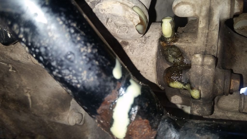

water pump: so while it was up i pulled the plow plate since it was unaligned then the plastic skid plate, power washed all the boogers out.
Let it dry over night. Saw the drain hose was milk shake. Pulled it off got goo out of it. I put a longer hose on yrs ago routed to the handle bar area.
So looks like i got do seals . I see a set on e-bay for 90$.

I got the water pump done and greased the ball joints i was not a fan of poking holes in the boots but it was a ver small needle like what they use to suck your blood.
