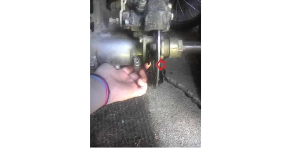

I have an 87 250x
i was riding it about...6-7 years ago and i put it in reverse and i heard a loud pop and then i heard a bunch of bearings fall and now i have this.

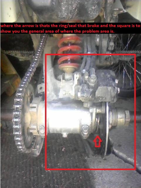

theres a crack just on the outside of the singarm like something broke in between the swingarm and axle but i dont know what the part is

Looks like the outside edge of the bearing carrier, is there a groove on the broken part, thats were a big snap ring goes if that is what i am looking at you are going to need a complete new bearing carrier the bearings that fell out were your akle bearings, if you lift the rear end up can you wobble the axle around?

Yeah, I would say the bearing carrier broke at the snap ring, like 69 said.

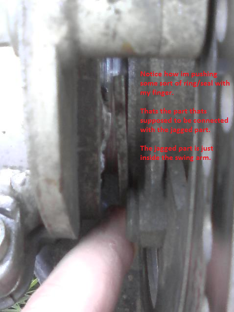

does the carrier have a black plastic/rubber piece inside? it felt and looks more like rubber but it could be soft plastic and yes i could wiggle it a little and yes it does look like a ring of some sort. the ring has a .5-1in opening on it

Yep your carrier is toasted... you can pick-up a new carrier for about 120.00 off ebay no prob. also the 300EX carrier is the same if you can't locate one for the 250X
