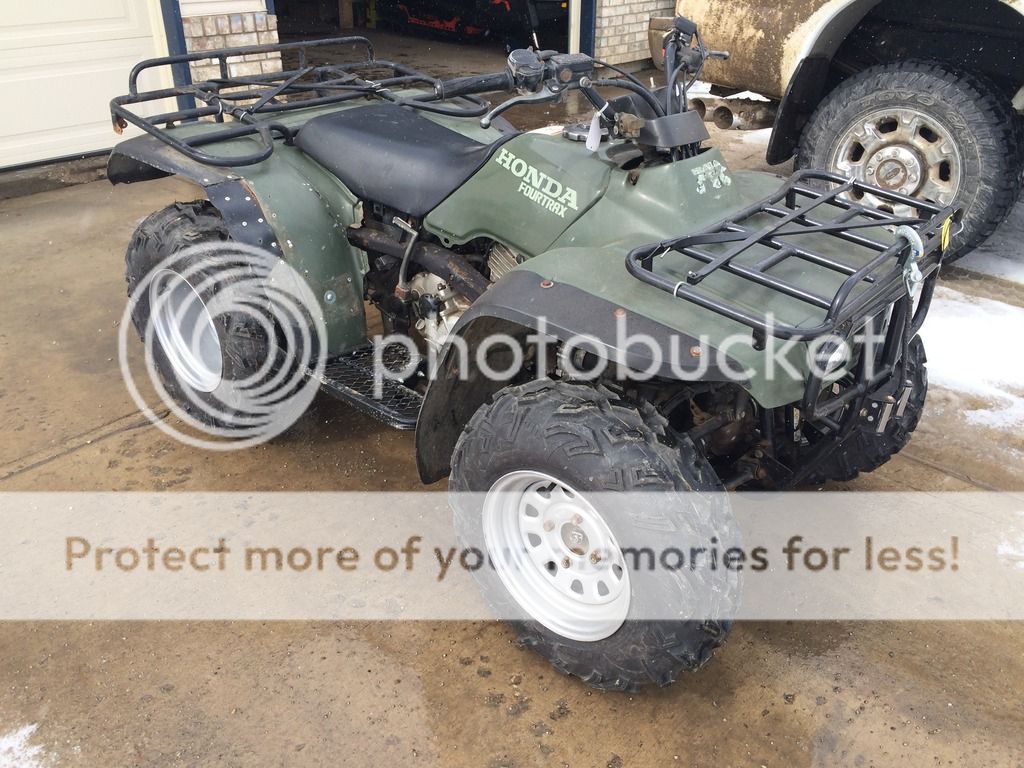

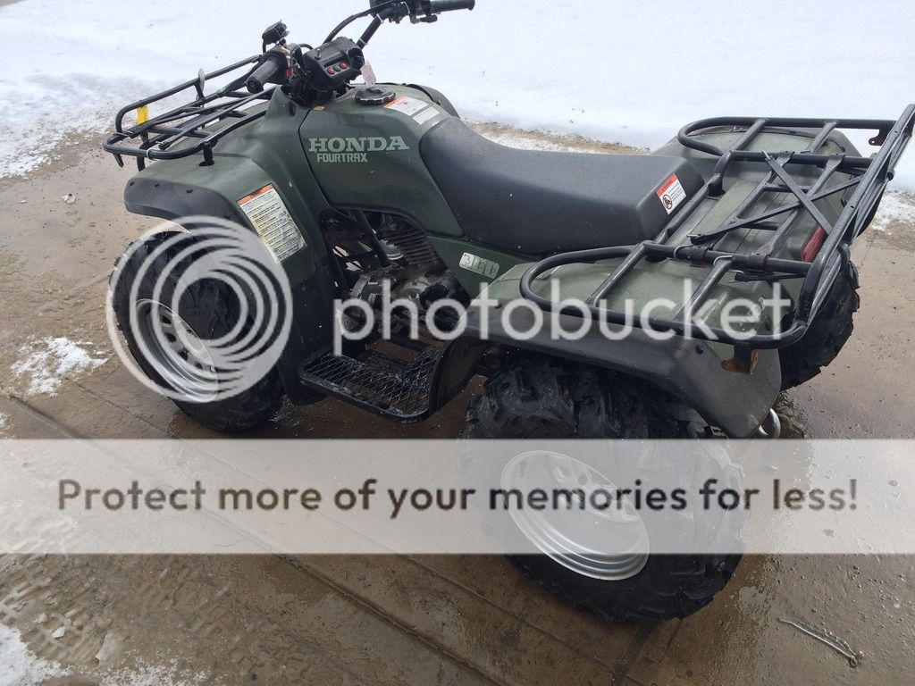

Click the image to open in full size.
There is a few of one with 12" ITP's and 25's that I ran for work.
Replacing rims AND tires on 4 is a but daunting. Although if you can find some factory take off's with rims I'd sooner run those than most of the OEM replacement tires mentioned in this thread lol.

Nice ride Mac! Are those 25" front and rear?
The Fab Fourtrax is offline
post #8 of 9 (permalink) Old 04-11-2019, 01:38 PM
Senior Member
mac102004's Avatar
Join Date: Jan 2013
Location: Nova Scotia
Posts: 7,130
Liked: 2037 times
Garage
Quote:
Yep 25 front and rear, that was my old work machine, well actually I made my helper ride it while I drove the Rubicon...but let’s not get technical lol
